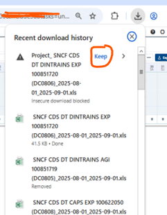

i need to click on keep option after clicking show donlaods button.
but issue is it is clicking the button but sometimes randomly it is not clicking which is creating the issue.
please help me to resolve issue , sugest other way so i can handle it properly
selector which i am using -
check ss below

@Mathkar_kunal Try changing the input method.
Note that the “Alter If Disabled” option only works when using Simulate Click.
@Mathkar_kunal,
The UI element you are trying to automate is very delicate.
I would suggest to either enable auto download in the browser without confirmation check or modify settings to show save as popup.
@Mathkar_kunal You can follow the suggestion from @ashokkarale , it will help make your process faster and more error-free.
If you still want tk click on keep button then you’ve to open the download page of chrome because the keep button is delicate and sometimes the issue persists, so open the download page after downloading the file using ctrl + j then use send hotkey tab (until the keep button is highlighted) then press enter using same send hotkey
