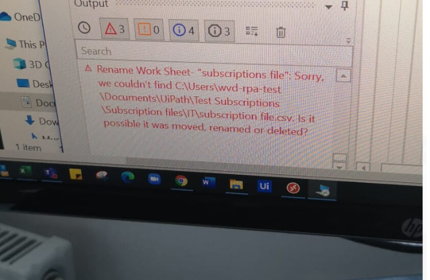

I’m facing issues while running the robot in WVD(Windows Virtual Desktop), all of a sudden the robot will encounter the below issues.
Error screenshot-1 :
In the above Error screenshot-1 , the robot has got stuck with the above error even though there is a file in the folder location path.
