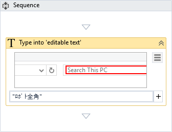

It will have something to do with the language encoding of system/applications, I think. For example, my system language is English and I tried “Type Into” on a windows explorer search box with some half-width katakana:
It works fine for me without conversion:

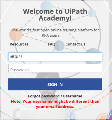

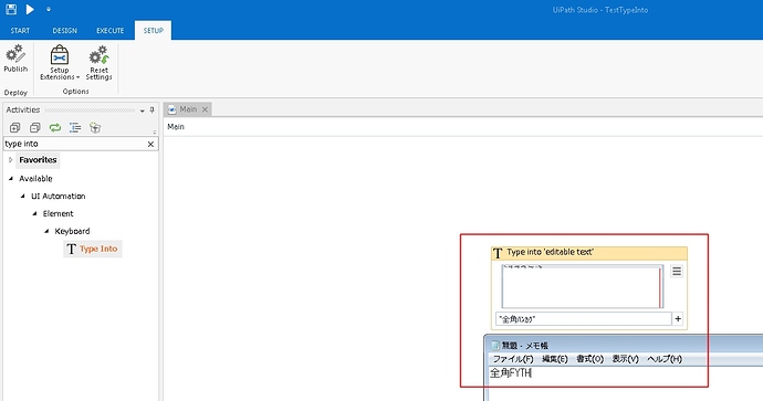

Hi!
If I Type into “半角カナ” in browser or notepad I get this:
Screenshot_11
Screenshot_13
Please tell me if there are not the correct characters typed(I’ve copy-pasted your examples and I’m not sure if the typed characters are still half-width).
