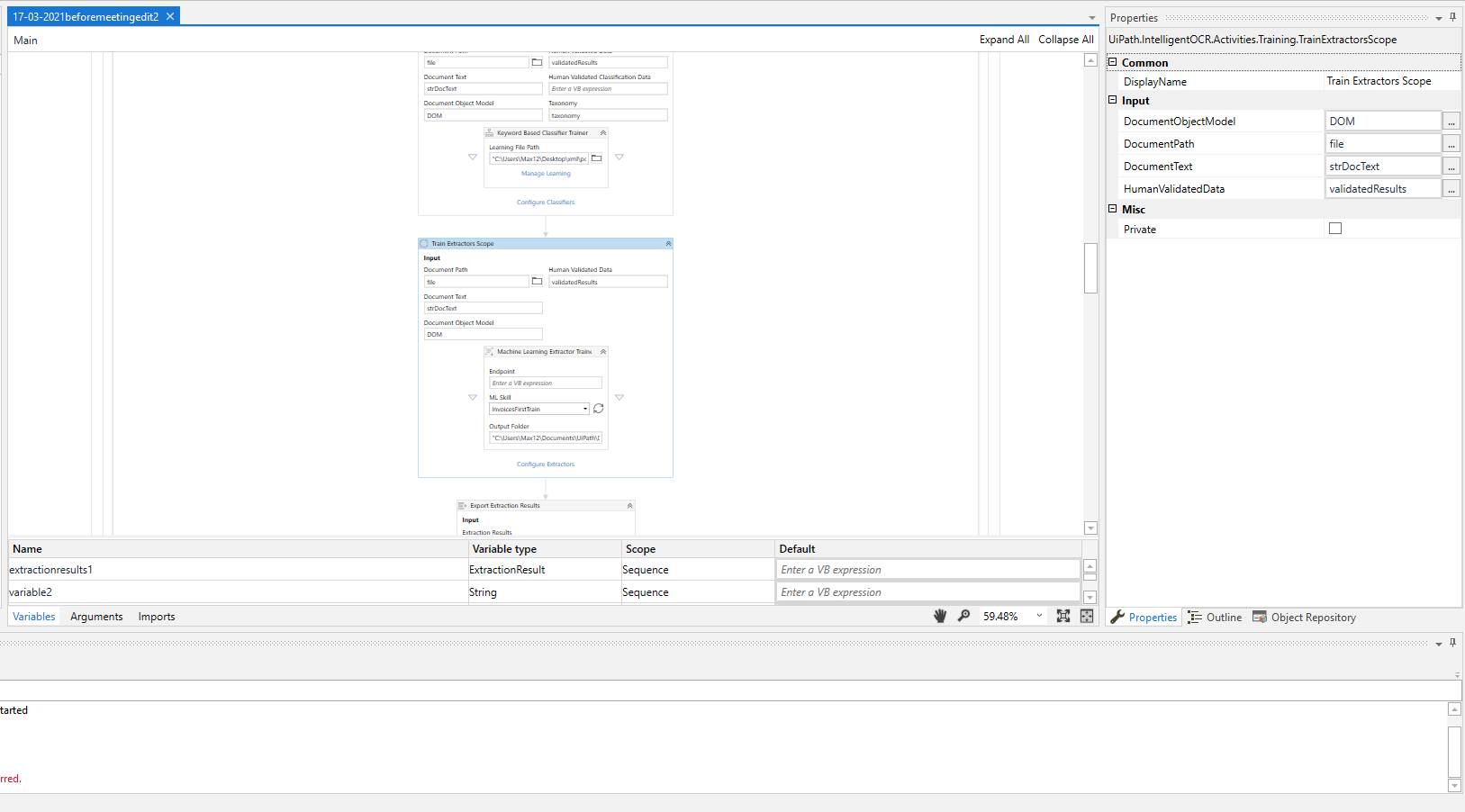

I’m using a train extractors scope in order to train the model on processed documents:
However, when using this activity with the specified ML skill my “predictions” output folder is empty after ~200 documents:
Is this normal or am I doing something wrong?

Hey ! Yes. For me, it was an issue in the extractor training activity. you should configure that accordingly and tick all boxes. I think it may be your problem too.
I had similar issue where folder ‘Predictions’ used to be empty, It got resolved for me using same framework alias both in Data Extraction Scope and Training Extraction Scope.
Framework Alias needs to be Identical in both the above mentioned Scope for both ML Extractor and ML Extractor Trainer Activity.
