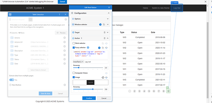

Hi @mkankatala @Vikas_M @B_H_Akshatha_Pai @pravallikapaluri @supriya117 @Anil_G
Thanks for your response.
If I Use Chrome browser its working. Its not working with Edge. Even though I indicated on next button, its not taking as button as it did in chrome
Thanks,
Abhishek
Vikas_M
(Vikas M)
July 20, 2023, 8:00am
9
Hey @Abhishek_Dharmapuri ,
Try giving an achor
i gave an anchor and it worked for me
Give an anchor which never changes when you move from first page to next one and so on
I have done this in Edge browser itself
Hope this helps ,
