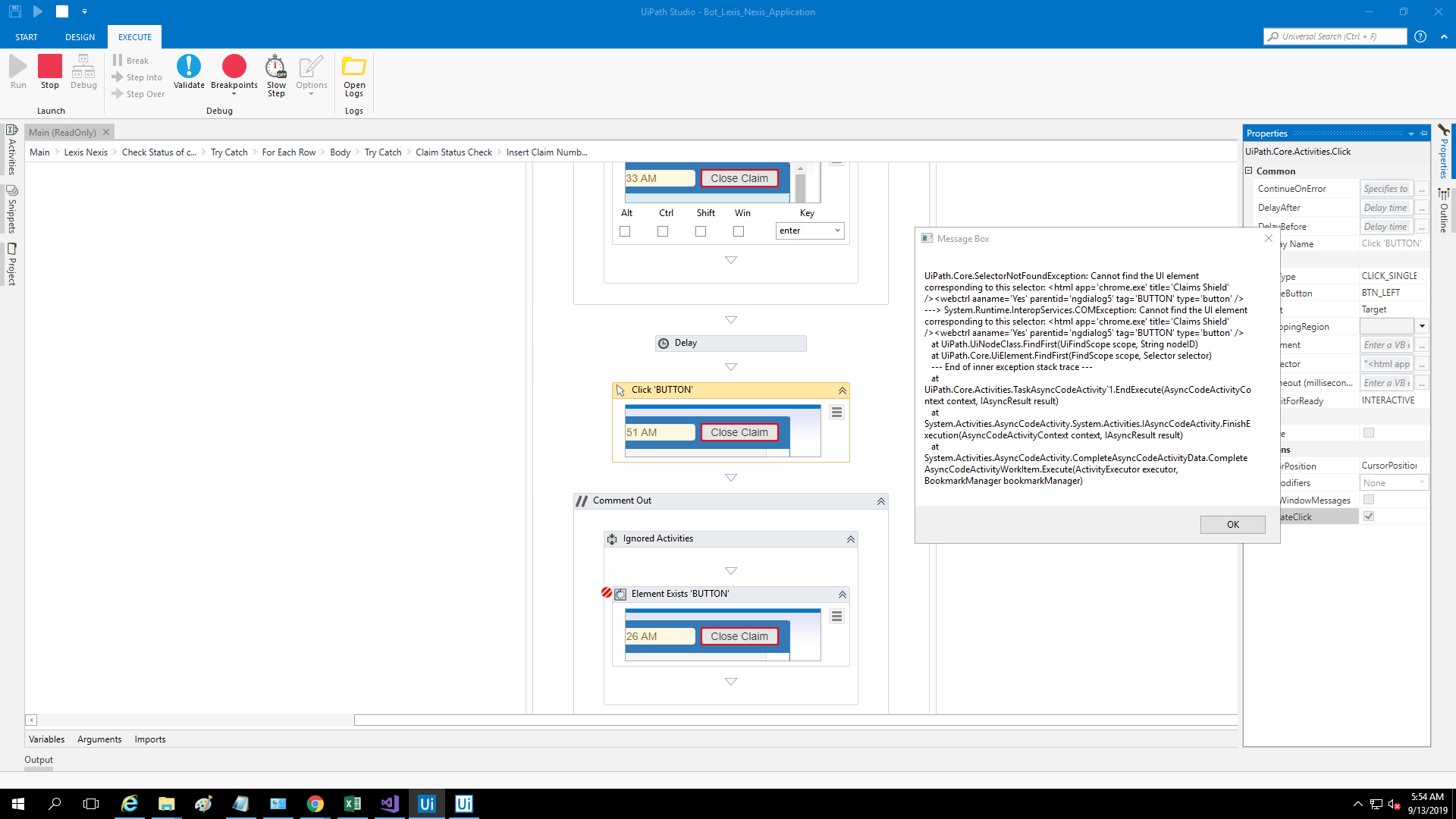

Hi everyone my selector not able to find the click object
can u pls provide the selector?
Parvati
yes thanks for reply
error I am getting uipath.core.selectors notfoundexception
can u provide selectors?
remove “idx=1” from selectors.
thanks I already
eg I have 200 records its work fine for 12 records after this I am getting error on click button.bot not able to click on close button

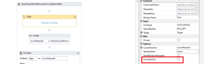

i have share u the image for simulate click.
its work fine but after 10 records not able to work
yes but have u click on " simulate click " checkbox?

@parvati yes its work fine for 13 record but after this I am getting this error
