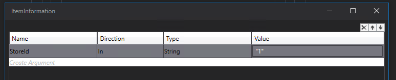

In your ‘Add queue item’ activity update the ‘ItemInformation’ to include “StoreId”. You will need to use some logic to determine whether StoreId needs to be “1” or “2”

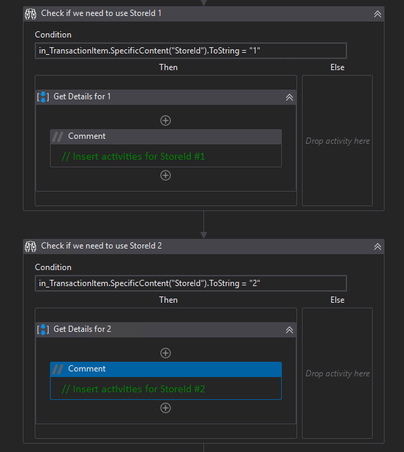

Hey
The decision is up to you. I would suggest two “If” activities like the following:
Or this:
Makes it easier if there was ever a third option.
You can also directly assign the value to a string variable:
