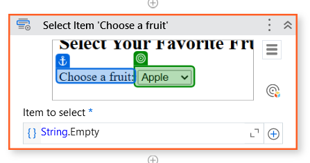

Hello,
When I select an empty field, the system prompts me to fill in the field. However, I want the field to remain empty. The field should be allowed to remain empty without triggering an error message ?
Thank you in advance for your assistance.
Regards
Hi @lilo.noel
Can you try using String.Empty in the select item activity
Hope this helps!
Thanks for your help. It worked perfectly !
