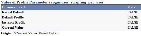

this behavior can occur if in RZ11 the parameter sapgui/user_scripting_per_user is set to true and you do not have the necessary rights.
Please take a look at RZ11 if this parameter is set to false.
