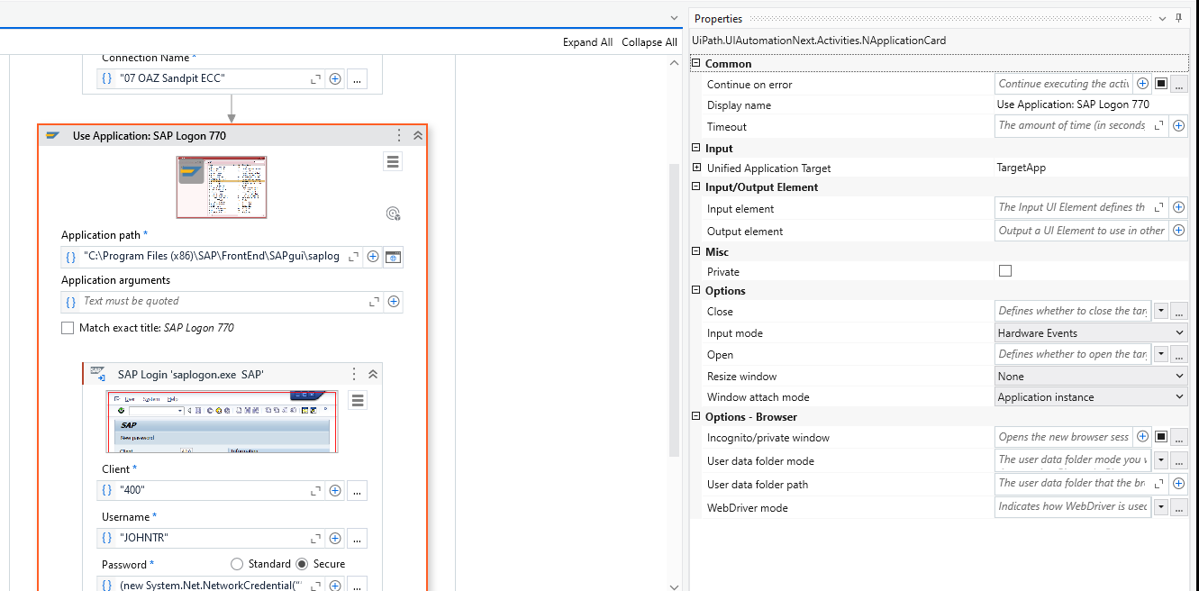

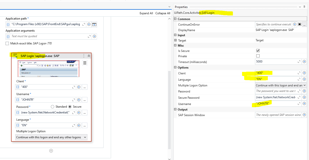

Not sure what you mean. Here is screenshot . looks like the “LOGIN” process has the correct window selected, as you can see CLIENT field

As per error it is clear that the selector is not being identified…can you show the properties panel of logon and scope as well

Here are some screenshots of properties
Hi. Got it to work. the issue was the “Use Application” activity which i saw in a YOUTUBE.
when i deleted that and just had
LOGON
LOGIN
it worked successfully
