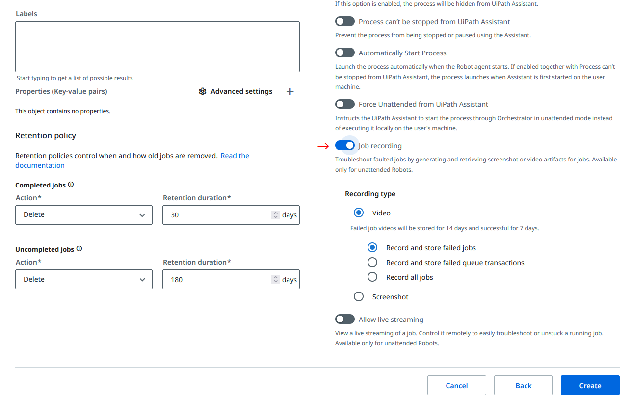

For now, can you check video or screenshot when error occurs, using Job Recording feature in Orchestrator?
If there is no video or screenshot, it may be session matter. Can you try to make all the users log off before run robot?
