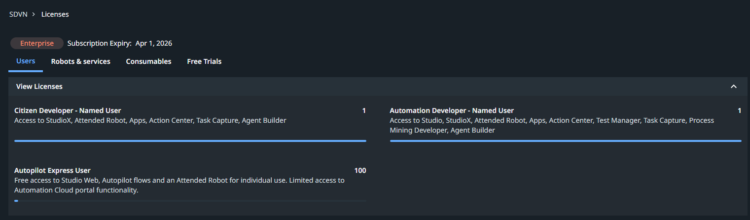

I have 1 Automation Developer license (using UiPath Studio) and 100 Autopilot Express User licenses.
When I build an automation process on UiPath Studio (user with Automation Developer license), can I run that project using UiPath Assistant of Autopilot Express User license?
