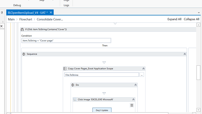

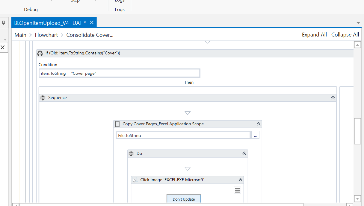

Background: I am consolidating the “Cover page” sheets of different files. When the Bot opens the file with linked formulas, an MS excel dialog box appears then the bot hangs up in the “Body closed and Body Executing” and also there’s no error thrown. I tried fixing it by using the following sets of activities but none of them works (or the bot does not continue doing the activities):
  1. Element Exist (to catch the dialog box)
  2. If and click activities (to click don’t update if dialog box appears)
  3. On element appears and click activities (to catch the dialog box and click don’t update)
  4. Attach window and click image activities (to activate dialog box once it appears then click don’t update)
IF Sequence within a For Each activity
MS Excel dialog box
Portion of activities where the bot hangs up
Appreciate your help on this, thanks in advance.

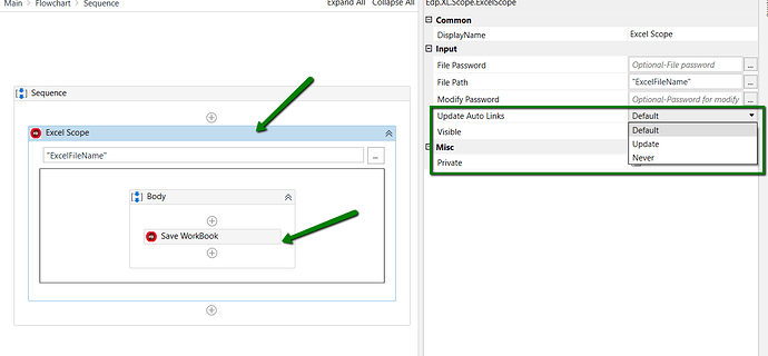

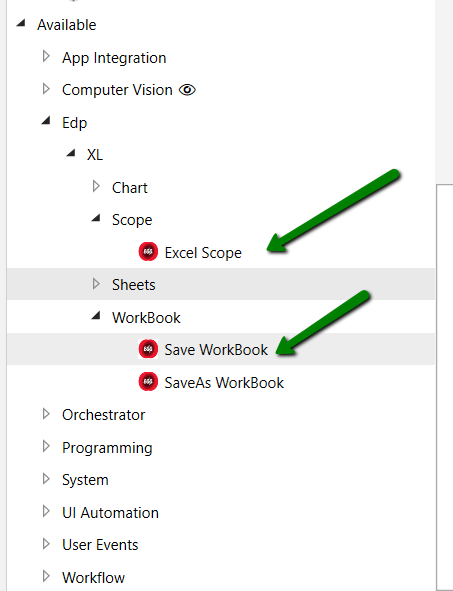

Hi @HILOMAP,
Here is the activity to update the excel link s.
Name Space :
Design Screen :
Sample :HILOMAP.zip (17.5 KB)
Thank you
Balamurugan.S

so is it possible to just add it before my Copy Cover Pages_Excel Application Scope?, just to suppress the update link dialog box?

Hi @balupad14
would just like to ask if edp is available in uipath packages? and if it is free?
thanks much:)
