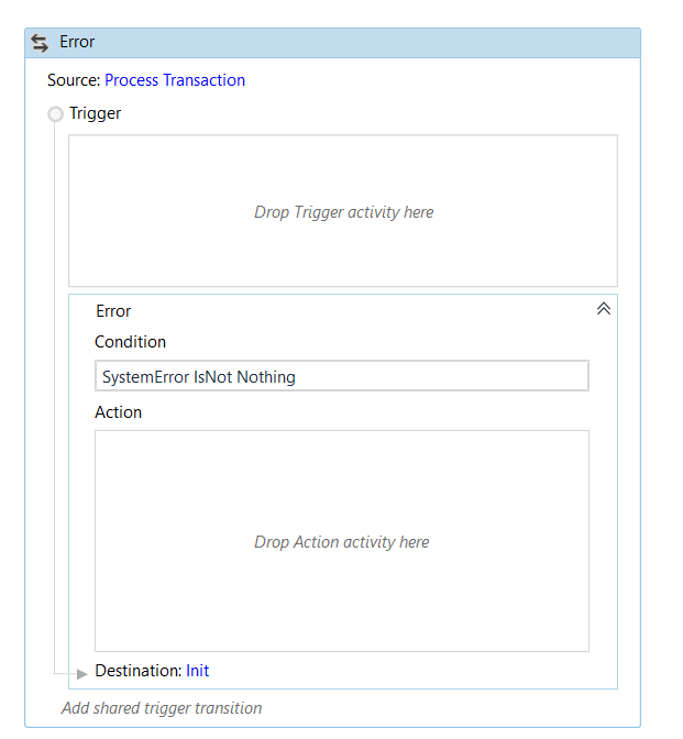

Hi, naturally it will only go to Init if the error is a system error. However, if you want to force the error you should use the throw activity in your process state where the exception occurs.

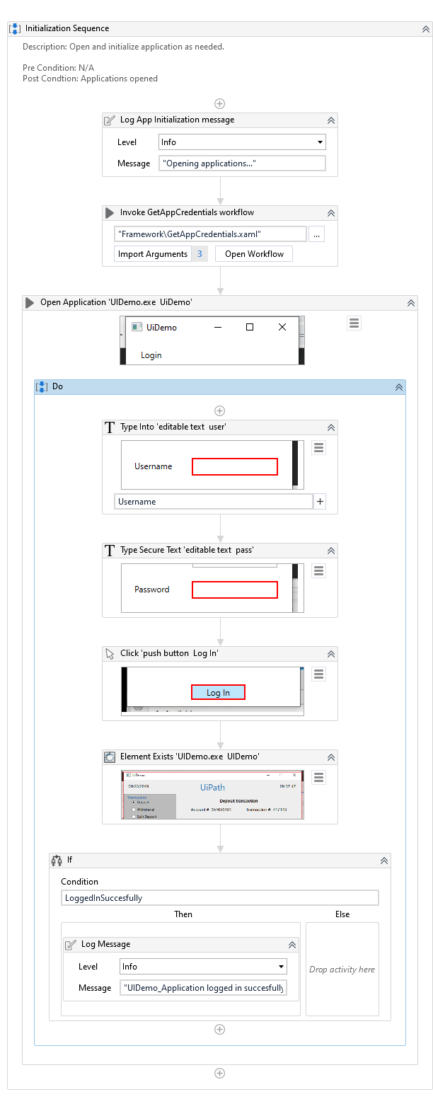

Hello @veselim.
In my case, Im try give error in this part(Image)… Where I put a Throw?
Thanks!
Throw a System.Exception (new System.Exception(“your error message here”)) inside Process.xaml in the place you need (For example, when certain condition is not met). That will force robot go to Error Transition
Process.xaml
Transition to Init
