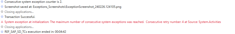

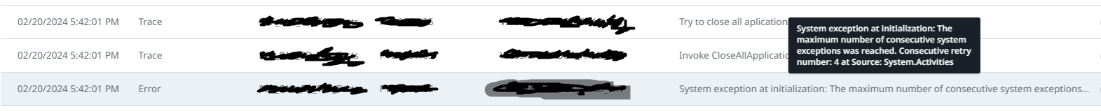

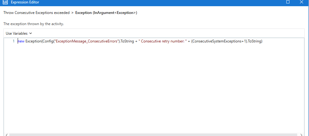

Hi all,
I have a problem regarding error handling in my project (Re-Framework). I have inputed logic considering max consecutive system exception, but when the max number of exceptions (set in Config file) is reached, the process is stopped and message is thrown, but the orchestrator marks the test as ‘passed’ not ‘faulted’. Any ideas why this happens ? Any help will be much appreciated.
