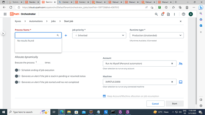

Hi @marian.platonov I could publish package to orchestrator but it is not listed when I try to create job. What could be the reason for same?
You need to publish it to your Tenant feed first.
If you published it to Workspace, only there it will be present.
Hi @Parvathy my issue is resolved after I changed test project to process in studio. Thanks for all your help!
