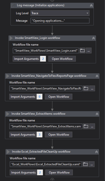

Because I’m aware of the expected result:
The workflows in my Init sequence are encapsulated in the above image, thus what occurs in orchestrator is that it only executes up to the third workflow and then stops, despite the fact that I have workflows in my Process.xaml that don’t execute at all.

It stops executing at the 3rd workflow it doesn’t execute the 4th one inorder for it to get into the Process.xaml

I just changed the close tab activity from after the wait Download Activty to after the If activity and everything worked fine.
