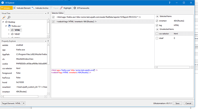

I’m not sure why, but UI Explorer doesn’t save the selector I make, and I have to reconfigure it every time I launch it. This validated before I tested my file, and had stuff in the white spaces.
Current:
After I just reconfigured it:
And here you can see the selector appears to work:
But I have to modify it a little bit
But you can see that it still validates

This (screenshot below) is how things wind up when they fail.
1 is the problem, because it does not evaluate properly. No matter what I try, it never evaluates to “true”.
2 is the red herring because UIPath skips over the test condition and then fails. This is NOT where I need help.
