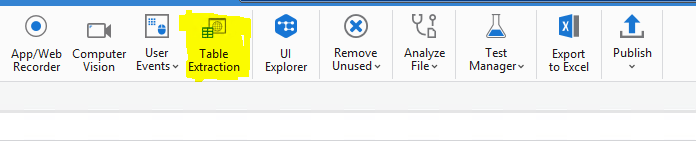

Did you try Extract datatable activity or Table extraction?
https://docs.uipath.com/activities/other/latest/user-guide/table-extraction
In Modern:
In Classic:
Hope this helps.
