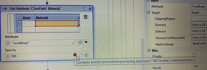

nope tried and resulting in error @Anil_G

I believe you had to use/Test with Set Web Attribute activity where as a Get Attribute activity is seen.

Oww i dint see you were using get…nice eyes @supermanPunch
@Anil_G how set web attribute will help me in this workflow?
@Tanzill_Ahsan
You wanted to change scroll max attribute…for that you can use set attribute and check if that allows you to change…if it allows …then we will set a different scrollmax value…and then type into…
As mentioned by you earlier…the bot is typing or entering only till the scroll max value…if we are able to change it then we can have more cells that can be typed…
So to change scrollmax value we are using set attribute
Hope this helps
@Anil_G thank you for your explanation
so the design of the workflow will be like this, if I am not making any mistake?
@Tanzill_Ahsan
Yes …that correct…selector will be the same one where you want to change
