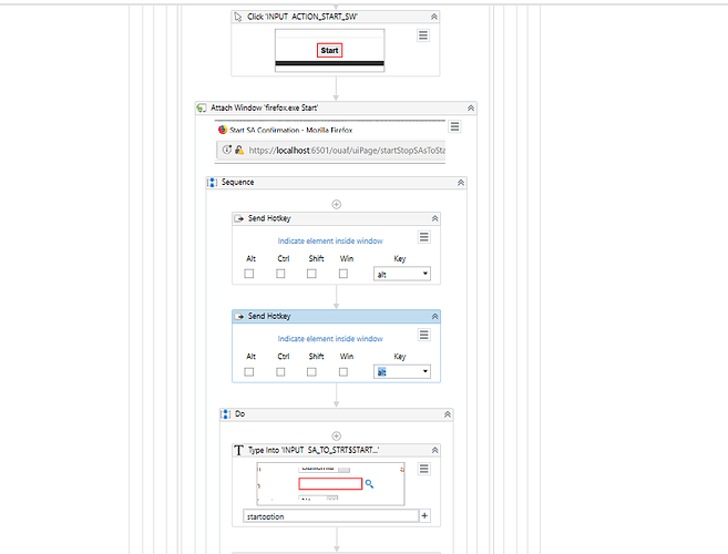

I am working on the ui automation, wherein i need to enter the value to webpage and i am stuck at one place, where i need to use “click” activity which basically opens the pop up page, on which i need to enter details, but as soon as i clicked, the pop up window gets opened, but after that it gives an error, cannot find the ui element to the selector. I tried with type into activity, i also tried with attach browser and attach window activity,but no result, can somebody tell me what is going wrong here?
Make sure that click activity is used with a ATTACH window activity and simulate click property of the click activity is enabled in the property panel or click activity

Few doubts over what u said.
1)what you mean by click activity is used with attach window activity
= I am using attach window activity right after click activity, is this right and is this what you mean ?
2)Since it is stuck at the place where attach window activity itself, will it run hotkey, since it comes after attach window.

may i know why we use alt key
tab will be usually right to navigate across fields

there are two options…
–as it looks like browser level use attach browser and place these sendhot key and type into activity in it (remove the selector in type into activity as we are using sendhotkey)
or
–without this attach browser try only with these activities that include sendhotkey and type into activity (remove the selector in type into activity as we are using sendhotkey)

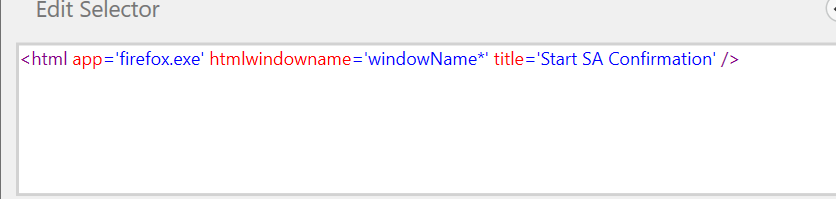

sure…it worked once…and happily went to lunch…when i come back it seems like not working…anyway let me try the way u suggested…
may i know what is the issue you are getting now
@Rajesh_Acharya
Issue is solved now, it was becs of the selector, when the selector is like this
it works
if it is other than this, it was not able to find the ui element.
thank u so much for all ur tips
