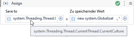

I have the following assign in the initialization:
However, this is only needed for a date calculation in the part of the dispatcher.
Can this be the cause of the workflow error and how can I fix it?
How about deleting the Assign activity?
This is required for the date calculation in the Dispatcher. If I don’t let the assign execute and go directly into process editing, the error doesn’t come.
How else can I use the CultureInfo for the date calculation for Germany or how can I change the value of the CultureInfo of the assign?
