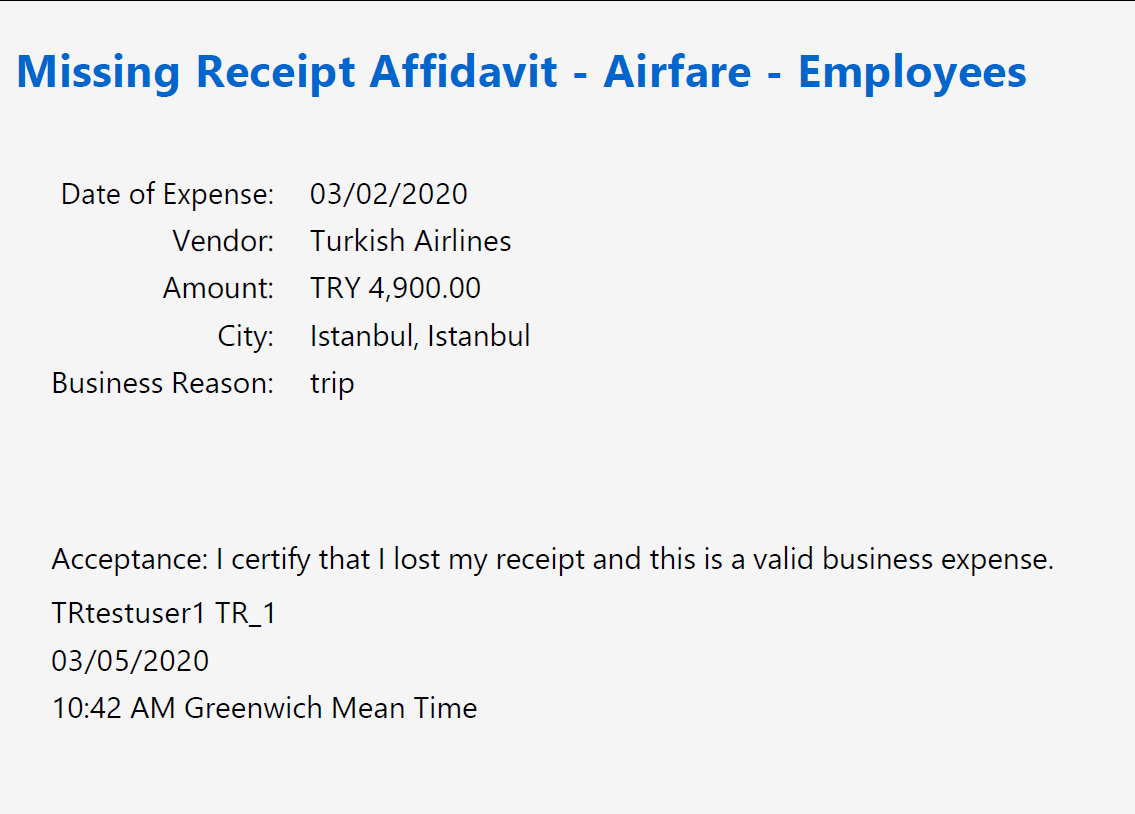

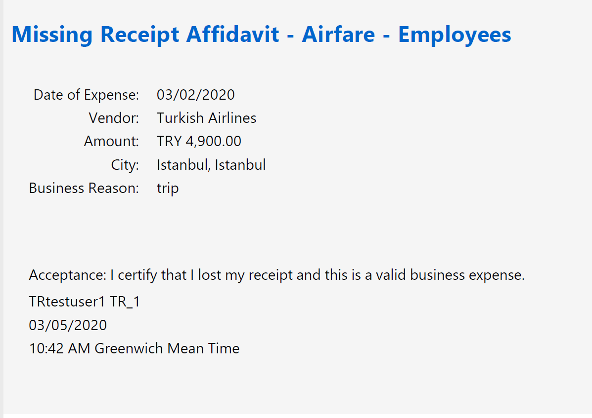

Something like this.
gWvIqkT5oDJkZKBb6WMdTipw9xpoxTiCrZg[0].PDF (4.3 KB)
Hi @NIVED_NAMBIAR we can duplicate the same pdf to extract information from both to see if they match or not.?

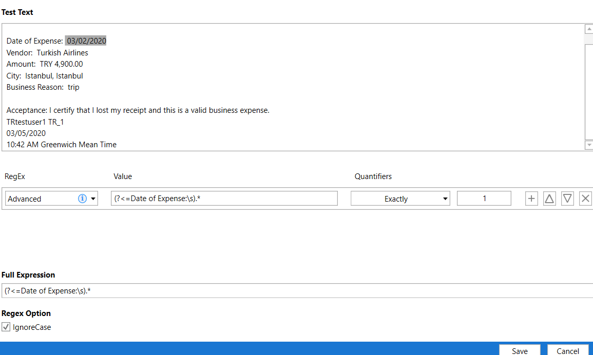

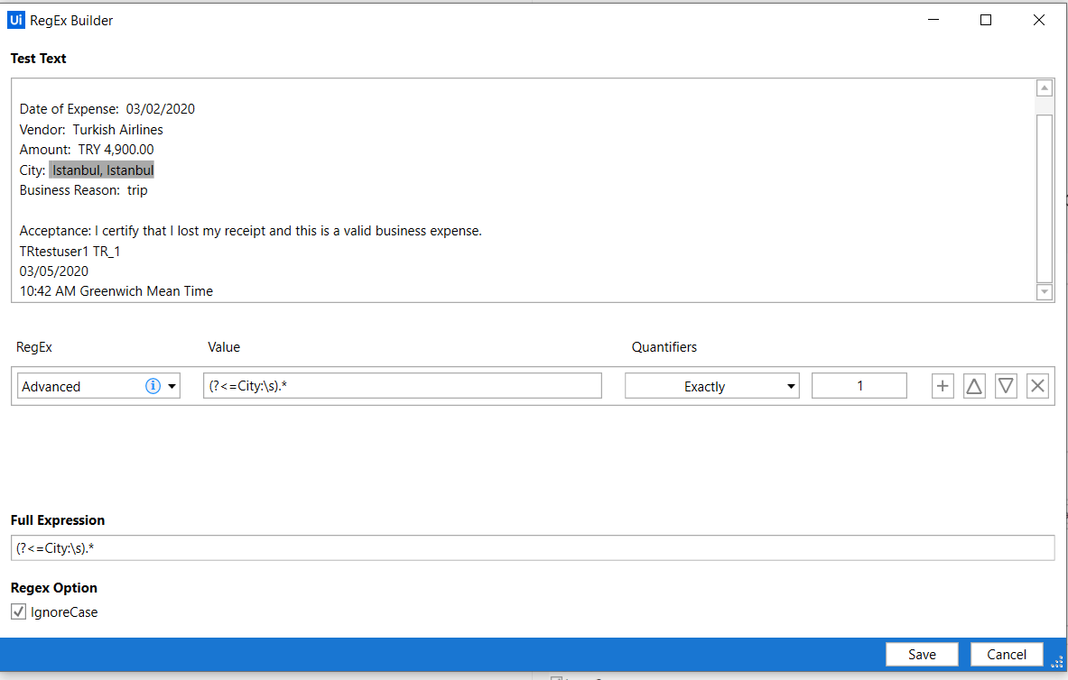

Hi @srinivas_pradeep thanks for this question
I will tell how to extarct the above data using regex

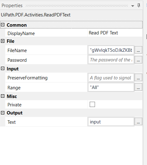

First taking the input file
a. date extraction

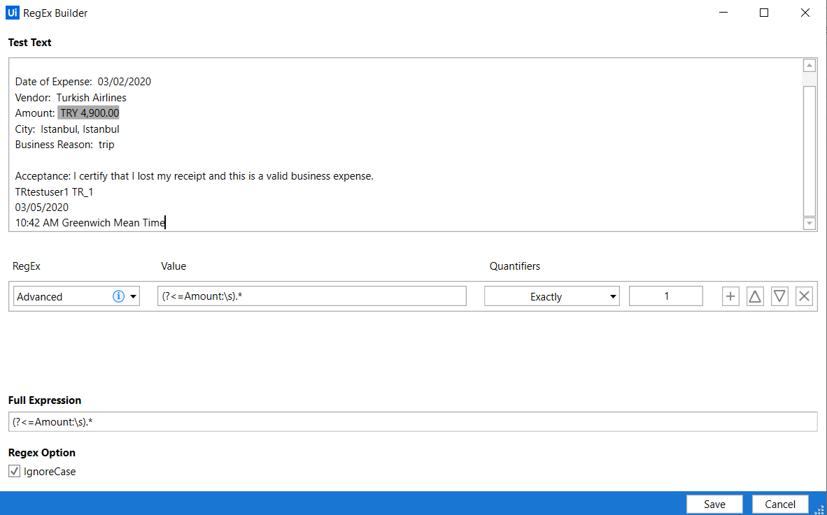

b. Amount extarction

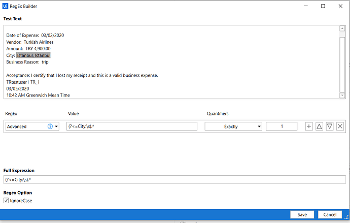

c. City extarction
this is how u can extract the values. then u can use the validation condition to check whether values are from two pdf are same or not
Hope it helps you
