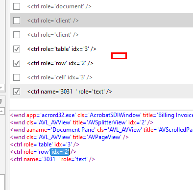

@Pratik_Wavhal
I am abel to get the Invoice ID for both the PDF files. Attached the workflow, can you help on this if possible.
Scenario4.xaml (31.5 KB)
Below changes was done.
<wnd app='acrord32.exe' cls='AcrobatSDIWindow' title='Billing Invoice Template - Adobe Acrobat Reader DC' />
<wnd aaname='Document Pane' cls='AVL_AVView' title='AVScrolledPageView' />
<wnd cls='AVL_AVView' title='AVPageView' />
<ctrl role='row' idx='7' />
<ctrl name='*  ' role='text' idx='2' />
Hi @sachinsm
First of all thnx for providing the selector that works 100% perfect.
May i know from where you got the extra tag or the idea which tag must be der somewhere that will help us to get the exact position of Invoice No from Invoice PDF Doc ??

@Pratik_Wavhal Invoice document are Structured document. Correct :slight_smile:
And the pdf file which you have provided are not scaned copped. so we can use Get text activitie to capture the text. When you use get text activity you will be getting thie selector, when u click on invoice no. and when you open new invoice the position of the invoice no will be same. but number will be changing. so he put * like ctrl name=‘*’
ctrl name='2170 ’ role=‘text’
Hi @vijaybrijmohan14
You are absolutely correct. I agree with you.
But the Selector which @sachinsm gave me afterwards includes “idx=‘2’” which i was not getting in my UI Explorer. I am talking about this tag only.
Otherwise the entire selector i was also getting and same i also did using * as wildcard to make it dynamic but after making it dynamic and when i do the validation for that particular selector in which “idx=‘2’” was not present then at that time it was indicating to the date which is beside Invoice No. So that was wrong.
Thats why i asked that how @sachinsm consider “idx=‘2’” should be include in the selector and so on by which it will work perfectly.

@Pratik_Wavhal
might be he have added row idx
Yeah. Thats what i want to get know how we can do it if any tag is not present then on what basis or the idea which tag must be der somewhere that will help us to get the value we want to extract.
If you are aware then let me know
Happy Automation :raised_hands:
Best Regards
Er Pratik Wavhal :robot::man_technologist:t4: :computer:
@Pratik_Wavhal we need to try all combination from the UI selector so we can get best possible match which can work in all similar case.
