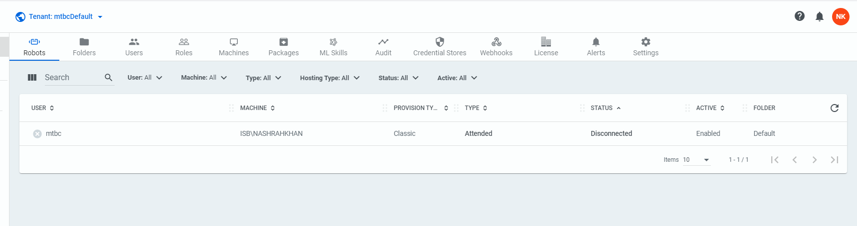

Open UiPath Assistant and connect to orchestrator
In Orchestrator provision the system
Once it done, you can click acquire license key
Hope this helps you
Thanks

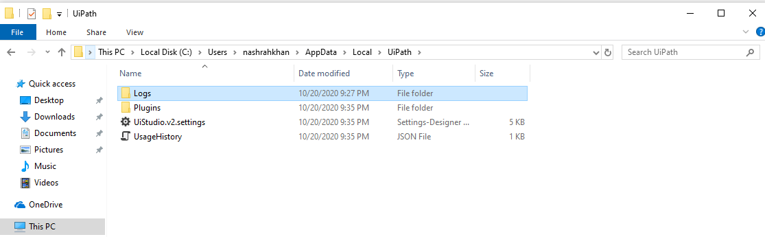

i am facing another problem of installing UiRobot.exe.
As mentioned in replies of other community forums we can find them in C:\Users\nashrahkhan\AppData\Local\UiPath
But unfortunately I didnt find it.
When I see this image, it represents that UIpath Studio and Robot is already installed but whenever I search uipth robot from the main search bar. i got no results.

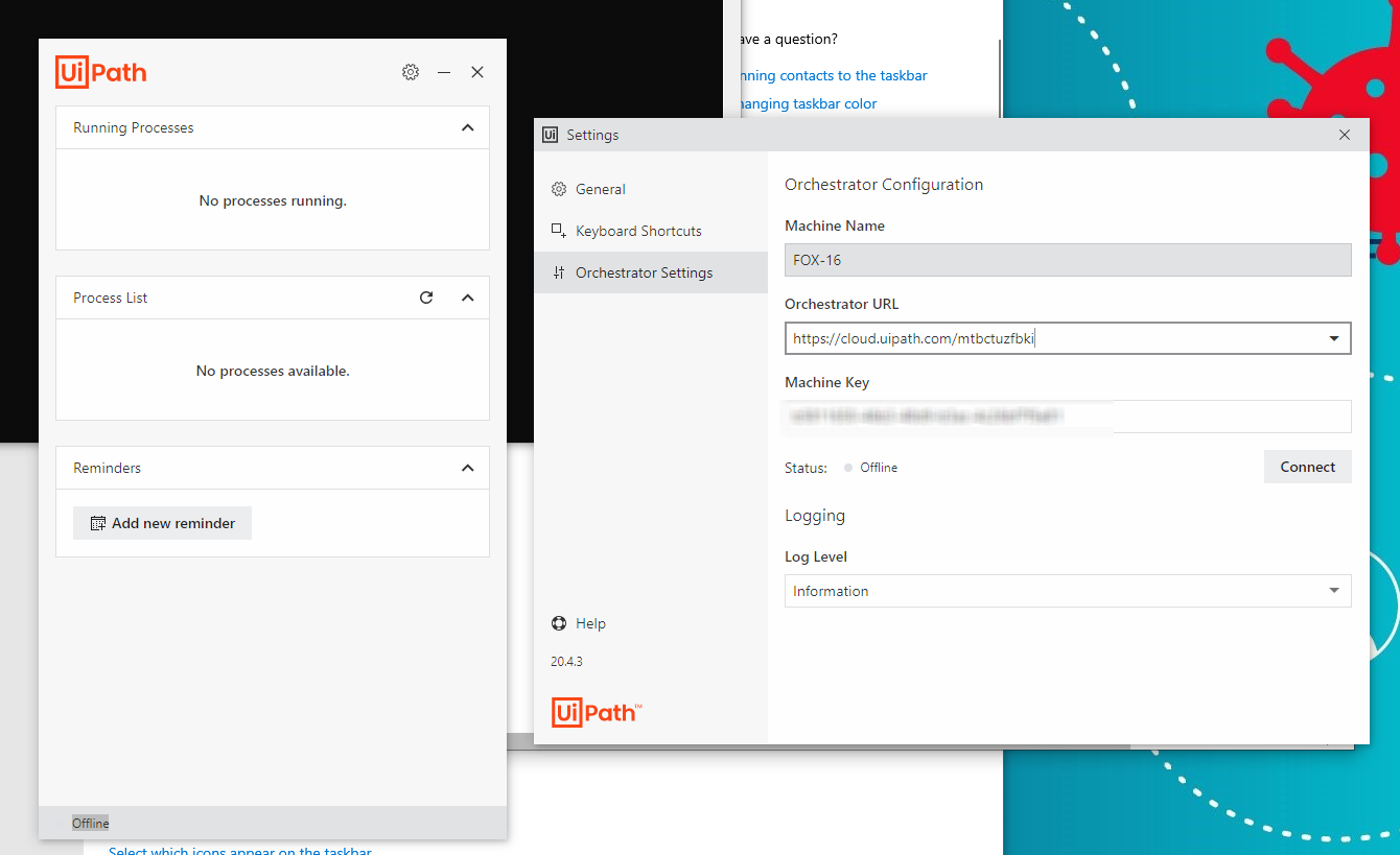

Yes uipath assistant is present
It is showing offline error.

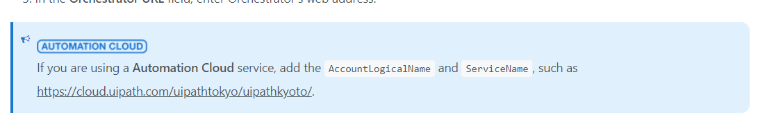

@nashrahkhan
give the URL of the orchestrator correctly, check as below
Hope this helps you
Follow Link
Thanks

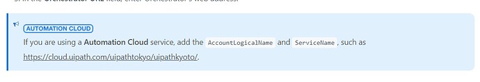

@nashrahkhan
Refer the below documentation
Thanks

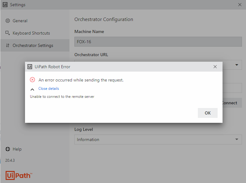

Now I am receiving this error.
Suggest you to install the community version
I am using Community Enterprise Version.
But still its giving this error.
