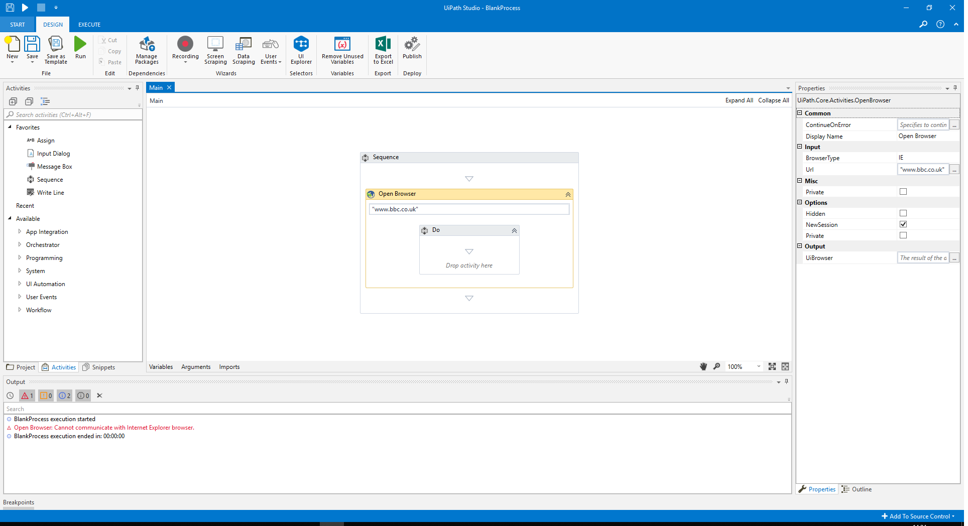

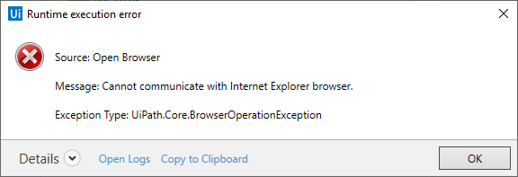

So I am basically cannot open anything with IE in Uipath. To do a quick test. I did a simple sequence with an open broswer activity and keyed in a url to direct the robot to the url in IE. It does not want to open the web page in and give me the following error.
My simple workflow
The workflow is fine and it opens so easily with google chrome. Only probably is that I need it to work in IE. Not sure what the problem is. I tried running the reg operation in elevated cmd. But did not work and tried the rest IE advancved options in IE settings.
