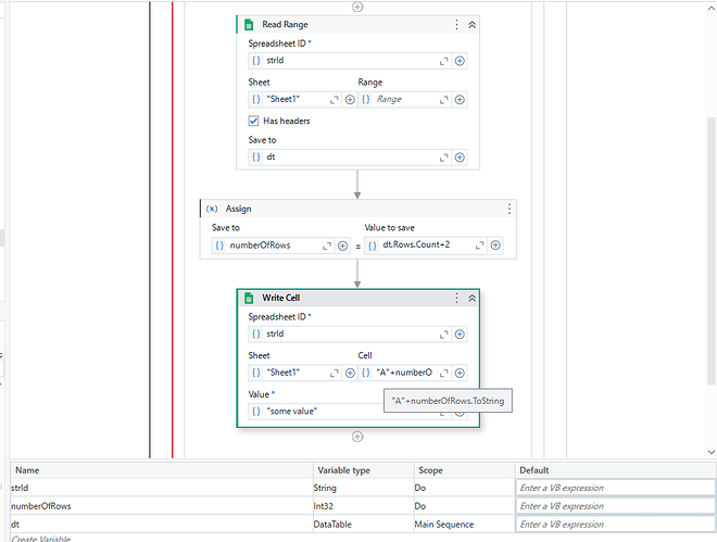

I need to write a column of data into the same column every week without overwriting what was previously written. How do I automate this? Write range asks for the starting cell and I can’t figure out how to make it the next open cell. Thanks.

  1. Read table as datatable using ReadRange. (Let’s say dt)
  2. Get number of rows of the datatable ( numberOfRows = dt.Rows.Count)
  3. Write target cell using WriteCell activity with the variable. Cell Address will be like "A"+(numberOfRows+2).ToString , for example. (Please modify column letter and offset value(2))

->First get the rows count from Data Table using rowIndex=dt.Rows.Count
→ next you can use the “Write Cell” activity with a cell address like “CellName” + (rowIndex + 2).ToString() to write data to the next available cell.

Hi thanks so much for responding. Are you able to include screenshots? I’m thinking I have to create a variable for the second step but don’t know what activity you’re using or how to do it. Thanks you!
Hi thanks so much for responding. How exactly are you using the data table rowindex section? Could you provide a screenshot per chance? Thanks you!
Hope the following helps you.
