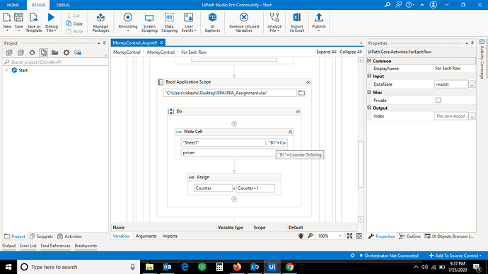

Hi Sarigam your Idea is working but one problem is occurring that it’s writing from line B10 and not B1, Can you please suggest what could be problem behind this, Below are the screen prints,

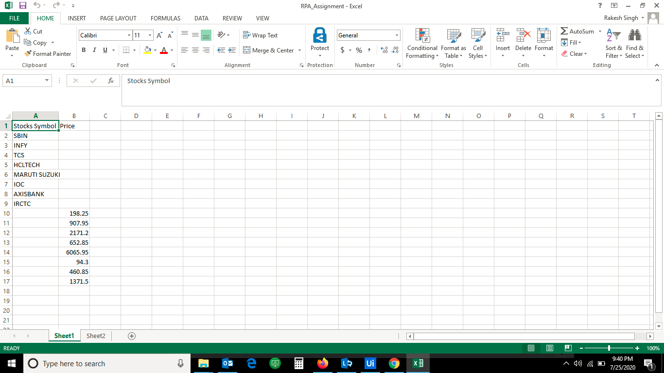

Excel I am using is,
Getting same issue…please help

You are incrementing incorrectly.
You have “B1” + Counter.ToString which results in B10
You need to change to “B” + Counter.ToString
Regards
