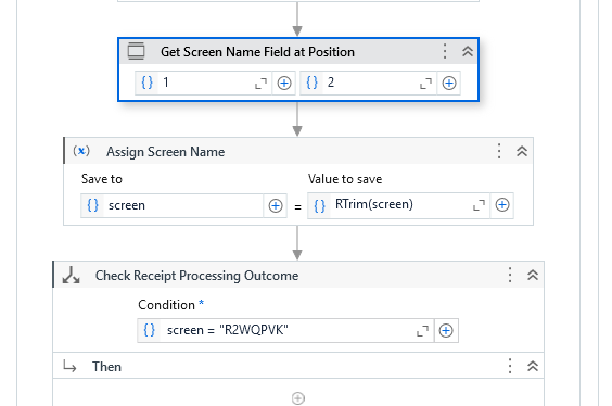

If its AS400 they usually have the screen name/code at the top corner; you’d have to do a get text from position, then check to see if it changes or stays the same.
