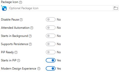

If you are running PIP mode in windows option - This is a known limitation. BOT won’t be able to take screenshot / any hardware events
Try changing the mode to session while running PIP and see if it is working fine or not
Go to Project Settings and change PIP Type

However as per organization policy, the PiP type option is disabled for us…
The current studio version what we use is 22.4.1

What is the default value selected in the PIP Type ??
