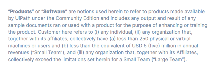

And just to confirm what is clear, is it possible to work with free versions (uipath community) in clients’ production environments? I understand that it is not, is that correct? If my statement is correct, how does UiPath identify this?
The Community Edition is allowed for small companies as well :slight_smile: See our Terms of Use
