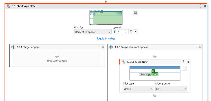

I am in the middle of excel data entry into web browser where it will enter the value and chcek if that exist and if it not then it will create that entry in the web browser.
The Sheet has column A (Item id), Column B (Description), Column C (Service Part - Category)
value always being with 9xxxxxx from row A3 till last row down.

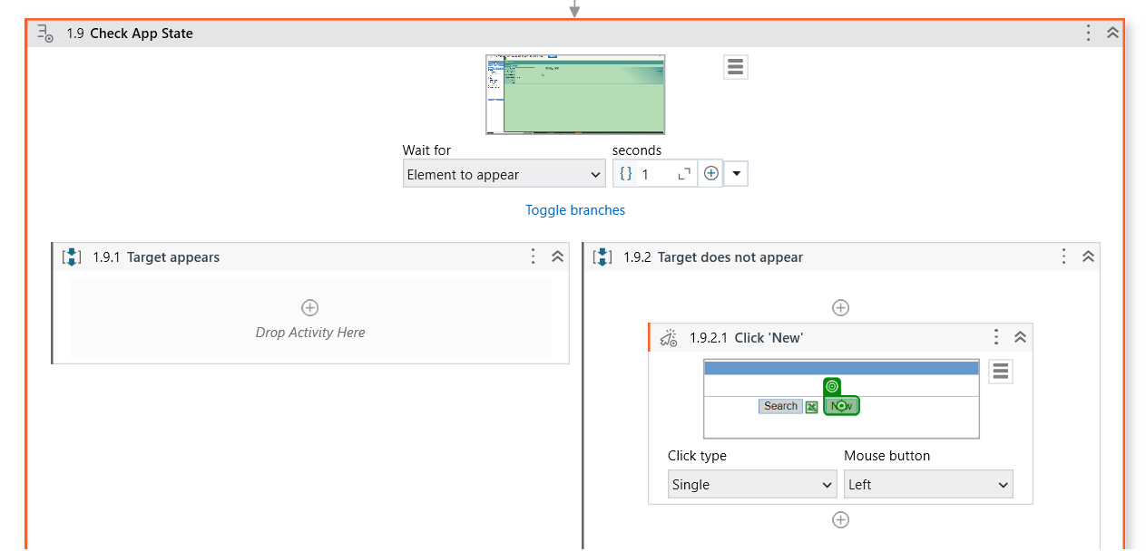

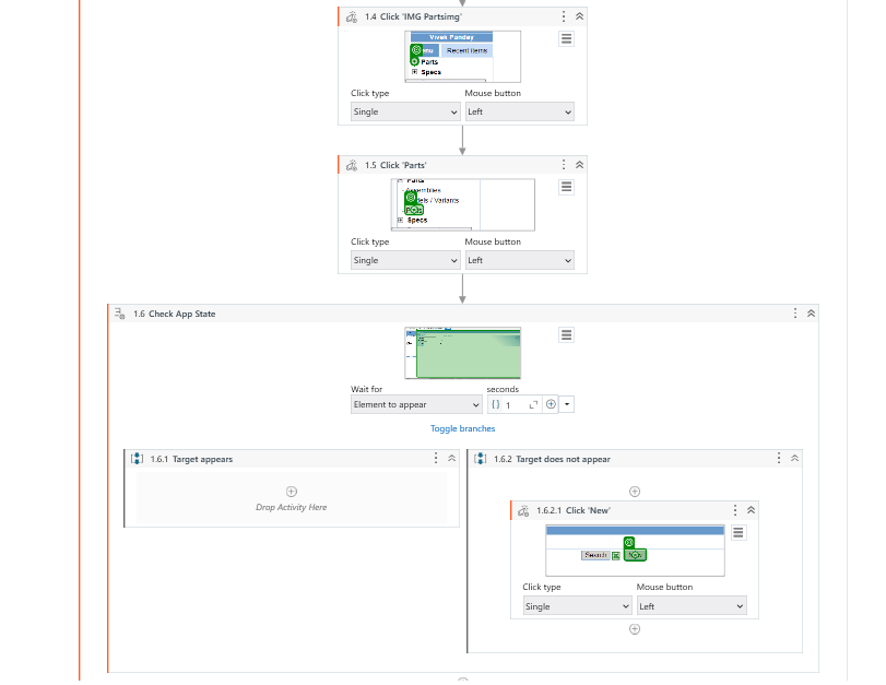

How can we write in studioX so that it can check the part number one by one in system and if not present it will create further in web app.

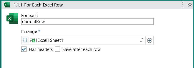

I am getting an error while, i use the For each excel row (CurrentSheet.Range(String.format(““A3:C{{0}}””, LastRow)):
@Vivek_Pandey2,

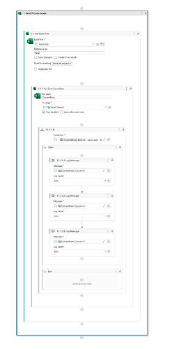

You should be using For Each Excel Row Like this:
No need to mention last row. Just specify Sheet name.
Here is sample solution:
Sample Code:
ExcelActivity.zip (60.6 KB)
Thanks,
Ashok :slight_smile:

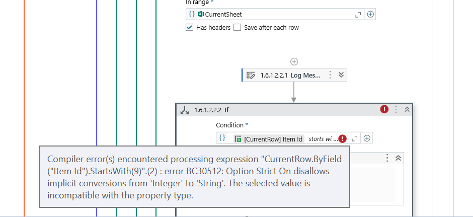

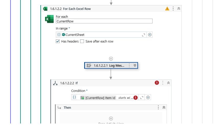

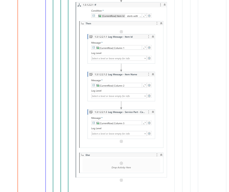

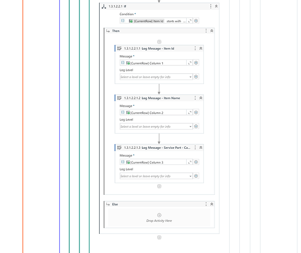

while doing so in IF statement, i am getting an error as below
Put that 9 like “9” in string. It should be string datatype.
Thanks for the response. The error is gone…

Hello @ashokkarale ,
I tried to reach here but the only issue is that how should I code for in that case.
If there are number like…
Part No. Desc
9XXXXXX-01 Part 1
9XXXXXX-02 Part 2
I want to code is such a way that it will go down with creation of part one by one…
