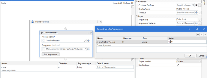

First set argument in Main.xaml of Callee project. (Let’s say in_argAnotherProcess)
Then In Caller project, use InvokeProcess with argument as the following image.

@Yoichi
It can be used when project X get the argument as a dynamic one ?
And I didn’t understand how to implement the name of the First project name in the “Invoke process” of the 2nd project - just type the name in quotation marks ?

Yes. Can you try the following sample?
Callee Task
Then publish and have it enable to run (If necessary, create process in Orchestrator)
Caller Task
If run, we can pass strMessage to Callee process (and show messagebox)

Can you try the following sample for Studio?
CalleeProcess.zip (2.2 KB)
CallerProcess.zip (2.2 KB)
