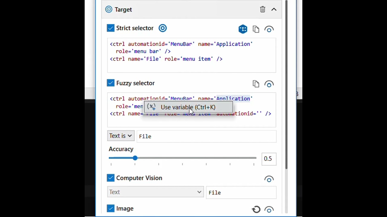

For creating dynamic variable: Just follow these steps as in below image.

in the object repository while creating the element and adding selector..in the same selwector give a name of the variable
which would be added to the project2 automatically when you drag the element on to any activity
there is no separate argument that is needed as that is how object repository work
