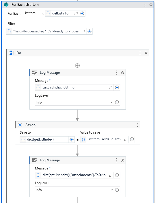

Hi @UiPath_Community,
I need to create a dictionary array for the list items fetched using for each list item as shown below. I am getting the list item index and then passing it with dictionary to create an array but when I run it throws me error at assign activity - ‘Object reference not set to an instance of object’. Thanks to @Yoichi for below post, I am trying to assign dictionary values like mentioned in below post:

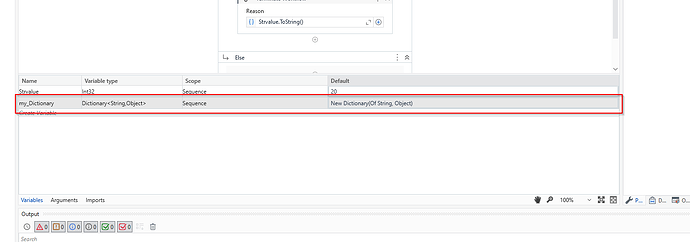

Hi @postwick @Achiranga,
Variable panel as below:
Please note, I have another dictionary(string,object) created as well, and its working fine, there is no need to initialize.
This error is only coming when I am trying to assign that dictionary to a dictionary array(shown in variable panel above).

Before adding the new value to the array, you have to initialize the new array member as New Dictionary(of String,Object)
Show me your code where you’re adding the dictionary to the array.

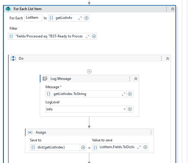

Its as shown below:
dict(getListIndex) = ListItem.Fields.ToDictionary(Function(x) x.Name, Function(x) x.Value)
Code works fine till the level I have initialized array in variable panel but based on the filter, no of items can change, so it needs to be initialized at runtime or some other way…
Then before that statement do
Assign dict(getListIndex) = New Dictionary(Of String, Object)
This will initialize the dictionary at the array location.
@postwick,
Already tried that, throws error in that statement itself if i add that.
Regards
Sonali
What error is thrown in that statement?
