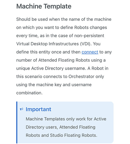

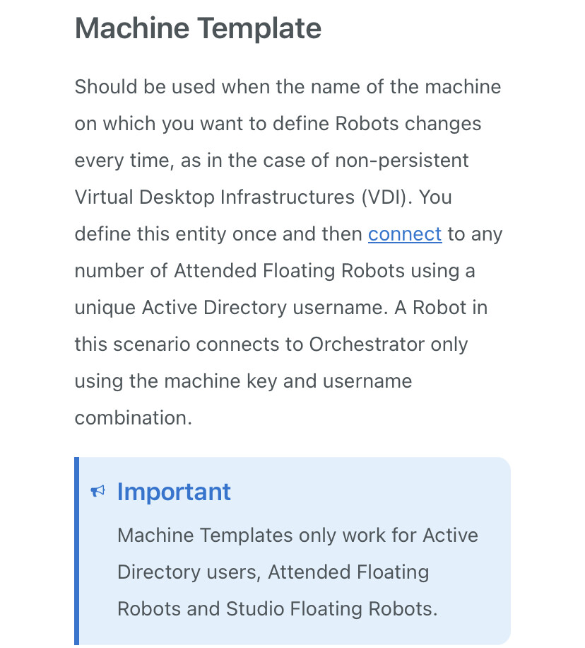

I am not sure if you are right regarding switching licenses between users. When you are setting up a template machine, you just select number of production runtimes used there, but you don’t specify any specific user. And later, at the process level, you can assign any robot user to this machine, so I think, that this license ‘floats’, but I am not sure.
Documentation would be helpful here, but I can not find the correct page.

I know, and I answered what will happen if you try to run them sequentially on different robot accounts whilst trying to share a licence.
The first robot will keep the licence and stop the others from running.
I have tested this in the past.
