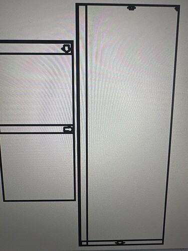

Could you share a screenshot how the the list of items looks like… @Raj_esh
Cannt share the original but this is how it looks . The bottom arrow is the one to scroll down to reach the item2 , which is not a valid hi element to do any activity
Tested with click image , this too not working
Okay @Raj_esh
There is a list of items right then use the for each UI element activity and indicate one item in the list. The output of for each UI element activity is CurrentElement.
After indication come back to studio and open the configure Filter option in for each UI element activity and give the value as it is follow case sensitive. Inside for each insert the Click activity open the properties and pass the CurrentElement to the Input element field.
It will automatically select the element that you have given in the configure Filter option in for each UI element activity.
