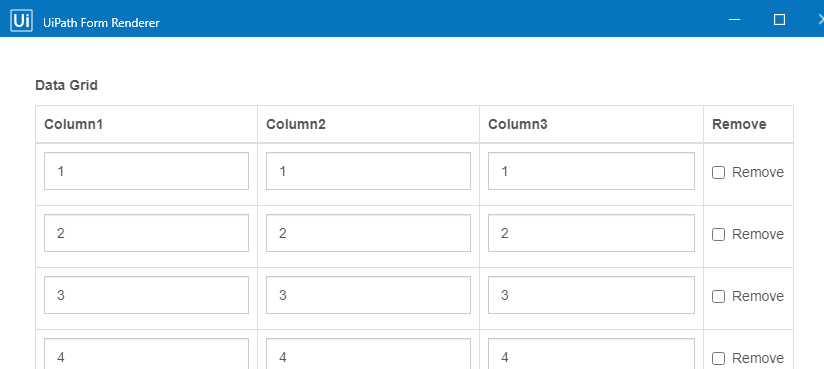

I’m sorry for digging up an old post, but you’ve done something I can’t figure out.
When I run your code, all the cells are editable:

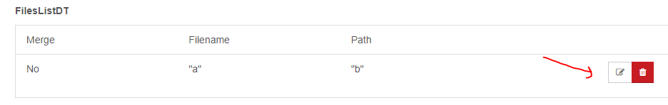

I have my own automation where I’ve used Create Form, and added a datatable to the fields collection, but when I run it the cells are not editable, I have to click an edit button to open each one:
How do I make my data grid work like yours, where the cells are all editable?
In that solution, A data grid form component was used…
Thanks
Nithin
Yeah it was so simple. The automatic form update was adding an Edit Grid for the datatable instead of a Data Grid.
