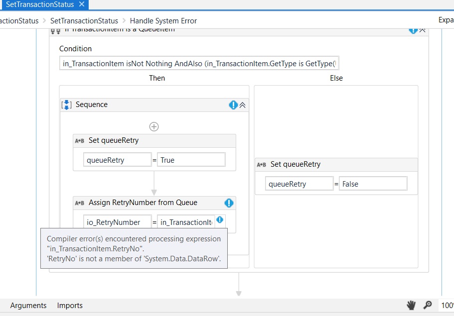

Hi @ClaytonM - Appreciate you taking the time and effort to go into these details. Thank you. I noticed that I have not used Set Transaction Status anywhere. The instructions in the assignment asked to remove all the Set Transaction activities from the Set Transaction Status.xaml file and so I did. (Screenshot below).

I feel like you need the Set Transaction Status workflow cause thatās also where the RetryNumber is incremented if it isnāt passed the MaxRetryNumber. Maybe Iām not a good person to ask about the assignments, though.
Essentially, the SetTransactionStatus.xaml gets invoked in the Finally part of the Try/Catch surrounding the Process.xaml invoke (inside the Process state). This allows you to increment the retry number when there was an application exception (and not increment the TransactionNumber so it retries the same item) and if it gets there and there was a BusinessRule Exception or MaxRetries were hit, then the retry number gets reset and the TransactionNumber increments so it gets to the next item.
If you have this workflow, you can see what I mean, or create a new Project using the REF template. Here is a snippet though:
And, it checks if the transactionItem is a Queue Type before using the Set transaction status activity, so there are no problems there. You can also set a status in the Data Row for your transaction if you would like to.
Like I said, though, Iām not sure why it would ask you to remove this important part. Either way, you do need to increment the TransactionNumber, otherwise, thereās no way to get to the next item. - This should happen at some point after the Process.xaml I think. The retry mechanism is useful too, cause errors are actually pretty common on most applications given the unpredictability of a Windows environment and the random functionality of some applications.

With TransactionItem set to DataRow type, I get the following compiler error within the SetTransactionStatus workflow. Shown below.
I deleted the sequence in the āThenā part of the workflow as recommended in another post. Compiler errors went away but it looks like I am getting stuck in GetTransactionData. Attached is the logs file.

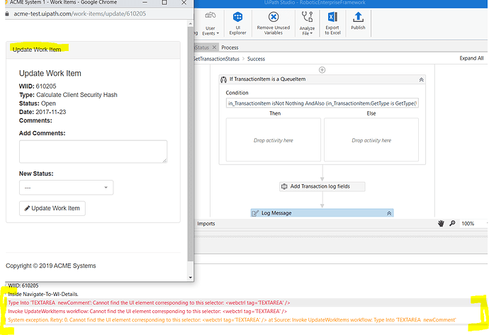

So I went past that hurdle after some much needed debugging (lol), I stumble upon the part where the script attempts to update the Work Item with the hash code. Error with the selector.
Screenshot below. Thanks again!.
Fixed the selector through UI Explorer⦠Letās see what errors out next. ![]()

As expected, another selector related error. This time itās the confirmation message that pops up and the goal is to click āOKā. Throwing an error with the selector there.
Hereās a screenshot with the selector.
Ended up using āSend Hotkeyā instead of Click activity. And it worked.
