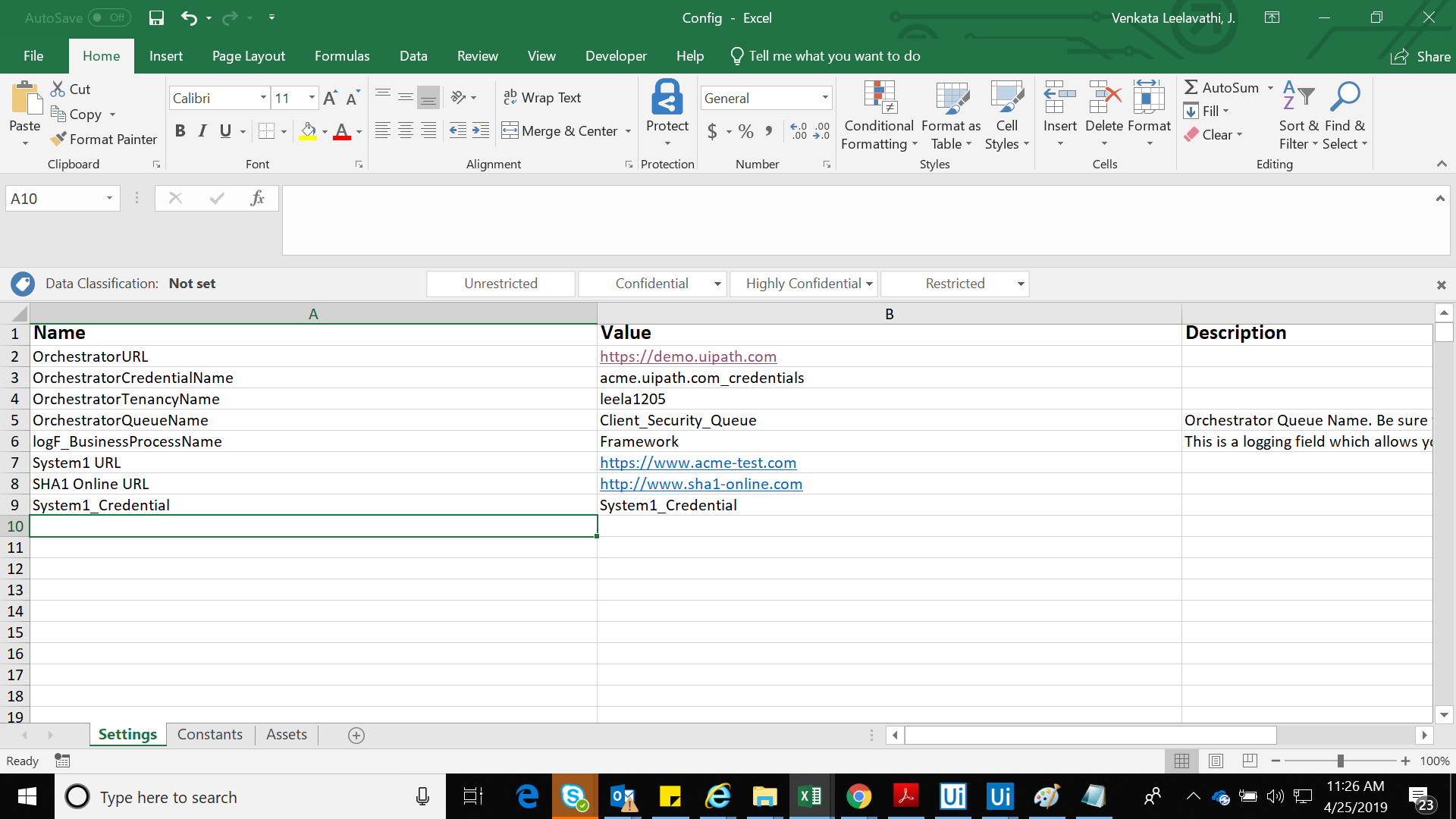

. As you said, I tried to System1_Credential = in_Config(“System1_Credential”).ToString
3. In config file, I have added now asset in the settings sheet . I thought to use System1_Credential both in orchestrator and also in the activities of Get APP credential and Login.Xaml .
Please correct my missings

Just to note: in my config: i have used ACME_Credential instead of System1_credential. Just make sure you don’t get confused…

Config file:

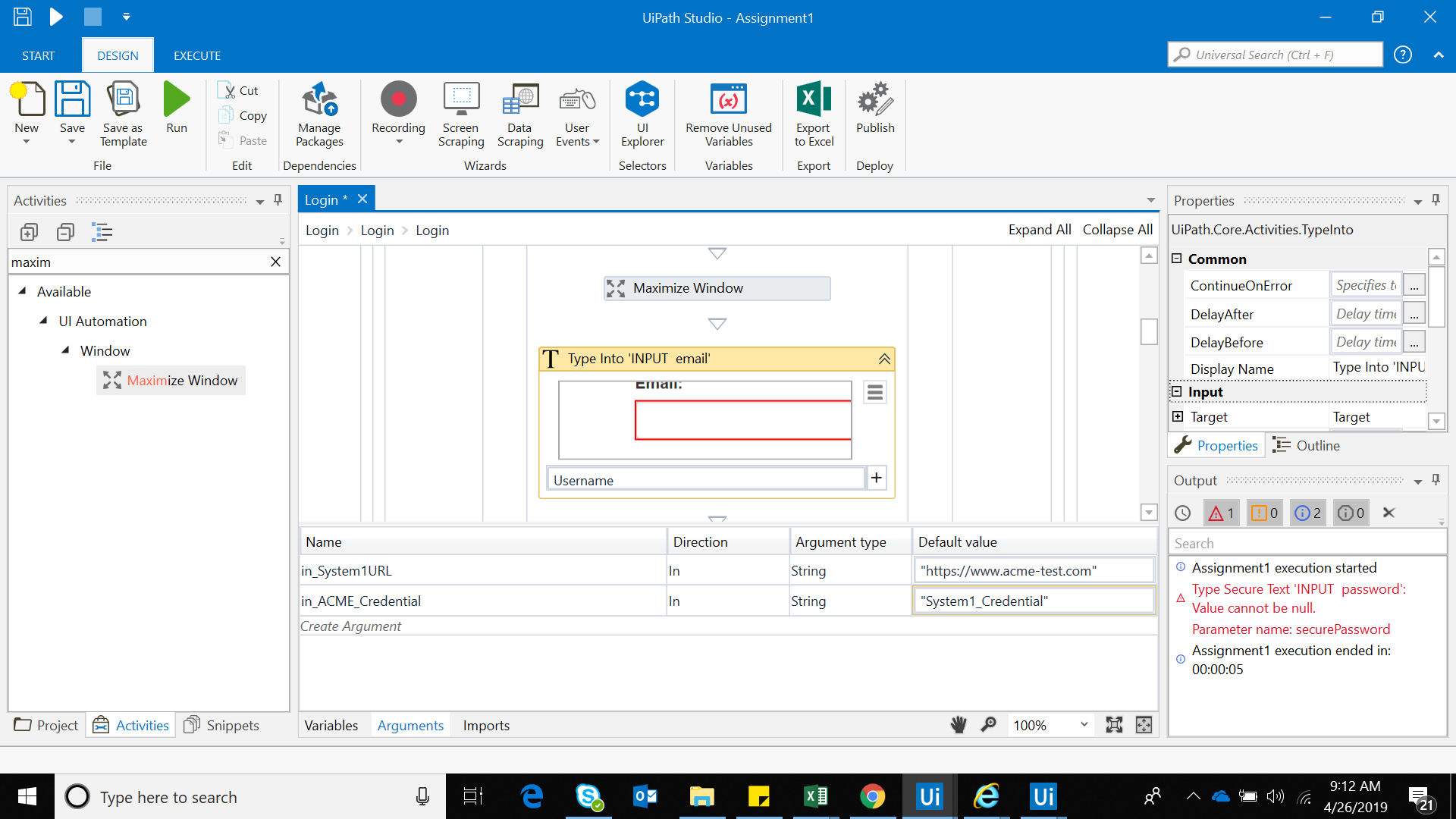

Well if you are trying to execute Login.xaml as an individual workflow, then you have to prodivde default values to your arguments.
Provide the credential data like this. You may also need to provide the site URL as well because your login.xaml do not know the website unless it is passed through the argument
This should work for you
Login.Xaml executed fine but its not getting credentials from Orchestrator like earlier and its prompting for windows password (2nd route -As you explained earlier)
I have given direct URL @ in_System1_URL - hence browser opeened for the same
As I am not able to fetch user details from Orchestrator, unable to enter same in username and password when I ran the login.xaml

Finally Login.xaml is working :slight_smile: Change I made by looking at yours is assigning default values after import arguments@GetAppCredentials

1 small doubt.
Why in_System1URL is not fetching value from config file?For the script to run I gave value in default

Additionally, From the config file screenshot, I see that the system URL is under the name “System1 URL”. One thing you have to note here is, when providing names, you should not include spaces in-between. So instead of the space, introduce “_” and make it “System1_URL”. This same thing should apply for your SHA1 URL as well. it also has spaces…
