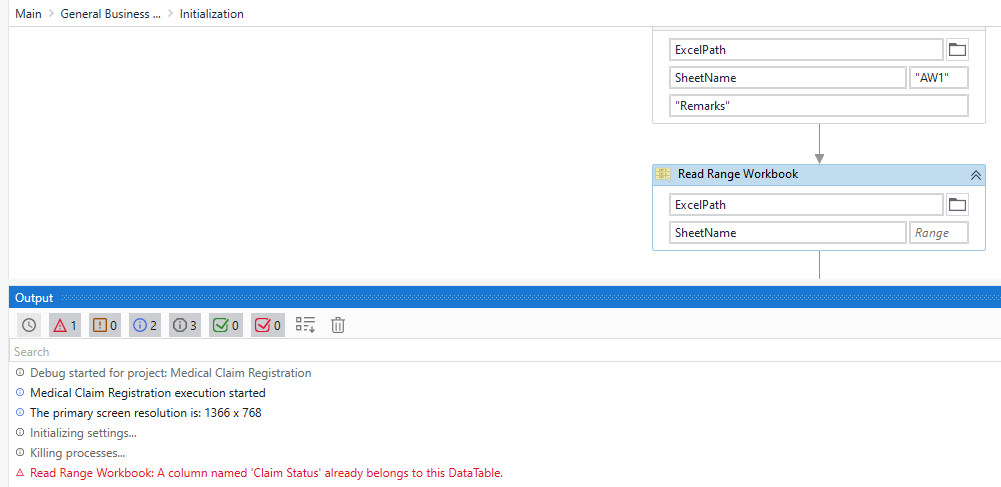

I have a process in which i want to read 3 excels one after other.
The process reading the first excel properly.
when RPA trying to read 2nd excel it is throwing error like below.
For this error i untick the “Add Header” in the property of read range, the thing is that iam using an invoke code activity which is using headers,
when i untick the add headers the invoke code activity showing error.
so is there any alternate way to solve the issue.
Hi @Gokul_Murali
You should uncheck the add headers option, UiPath will create columns and you should use those column names created by UiPath, pass the one that you need to the invoke code
Regards
Hi @Gokul_Murali
If you are taking the columns as a reference in invoke code then you have to check the add headers option in read range workbook activity.
Hope it helps!!
@Gokul_Murali Try reading it to separate Datatables and then you can merge all the Datatables into one by using ‘Merge Datatable’ Activity(Missing Scheme Action in property panel should be ‘Ignored’)
@fernando_zuluaga
i tried that also,
iam using an invoke code activity in that iam using header.
when i uncheck the “add header” invoke code activity throwing error.
@mkankatala
when tried but it is showing error like this.
Hi @Gokul_Murali
  1. Use Different Variables for Each Read Range, so the headers won’t interfere with each other.
  2. Store the headers in a separate variable and use that variable in the “Invoke Code” activity, allowing you to untick the “Add Headers” option while reading the data.
@fernando_zuluaga
How can i pass the column in the invoke code which is created by UiPath.
@Gokul_Murali
Check this thread hope it helps
@supriya117
How can i create 2 varaible for the read range
@Gokul_Murali
I mean, For each read range, create a new variable instead of using last one.
@Gokul_Murali
  1. You can use column index inplace of column Name in your invoke code as well
  2. The default column names assigned by UiPath would be Column 0,Column1 etc …so can assign those names as well instead of column index if you want to
Hope this helps
@Gokul_Murali In the property panel of the ‘Read Range Workbook’ activity, under the output option you can create new variables by pressing Ctr+K and then give a new name
eg: dt_Input1,dt_Input2 and so on
Please refer this video to create a variable
it will create columns like: Column1, Column2, etc… check which is the column that you need to use and pick that one
