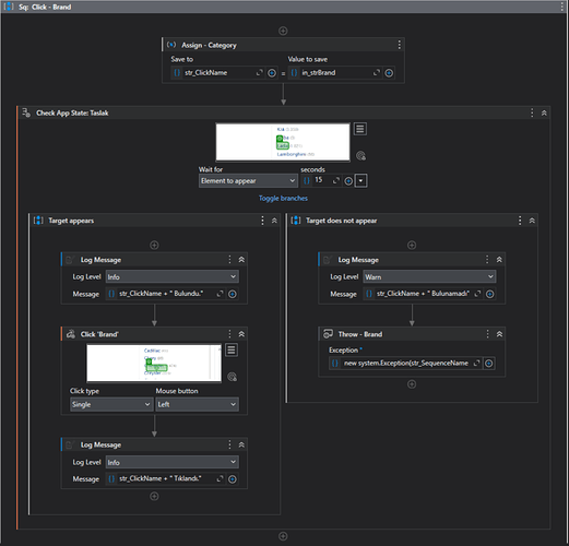

Click activity can’t find the element that i indicated ???
Strange thing is that ‘Check App State’ can see the element but selector(btw its dynamic) can not click it!

Can you try with simulate…
also the selector photos you gave look different in two pictures

It worked but why ???
Is it because of input mode ![]()

It solved by @Anil_G
It was about the input mode (hardware events, simulate and so on)
