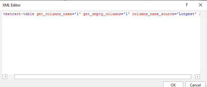

@yusufs.adi
This is what you get once datascrapping is configured to scrap the entire datatable. This question arise during the scraping configuration process.
But when you configure the scraping process column by column then you will get the extract xml and can rework it specific to the textfields
