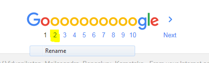

you can do how many pages you want by using dynamic selector for navigating to next page…
you can try this method:
  1. use UIexplorer to identity the selector for page 2.
Capture
  1. then edit the selector search for property name aaname=‘Pagenumber(1,2,3,…etc’) will be present, in this case aaname should be ‘2’ as i am clicking on page number 2.
  2. once you update the selector like this
aaname= ‘“+ Page_Number+”’
  1. use element exists to check next page is present
  2. you loop through it and once your page reaches limit, it will come out ( Use if condition)
thanks
