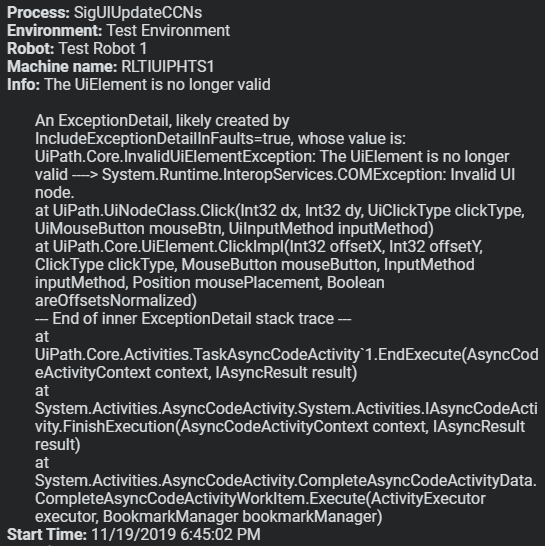

Again, this same process runs 100% successfully in every way EXCEPT when Scheduled through Orchestrator, and even then it succeeds some times but not in others. I’m not sure the exact error message it throws matters, but here are the 2 common errors that it throws:
An ExceptionDetail, likely created by IncludeExceptionDetailInFaults=true, whose value is:
UiPath.Core.InvalidUiElementException: The UiElement is no longer valid ---->
System.Runtime.InteropServices.COMException: Invalid UI node.
Process: SigUIUpdateCCNs
Environment: Test Environment
Robot: Test Robot 1
Machine name: RLTIUIPHTS1
Info: Cannot find the UI element corresponding to this selector:

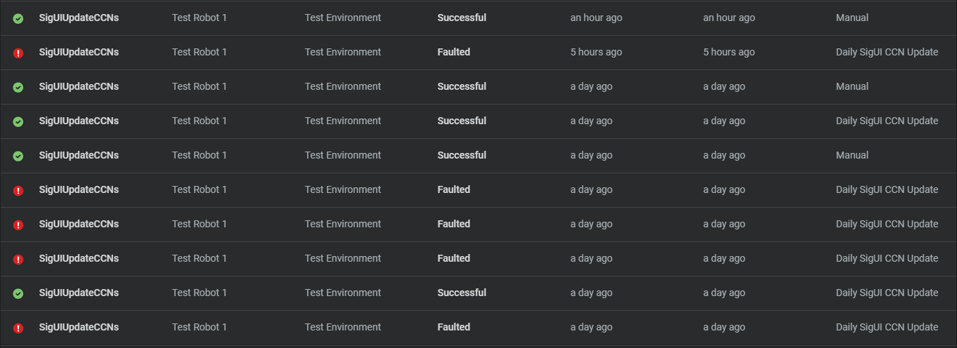

I have done both, yes. When process is manually run through Orchestrator it succeeds every time. I have also brought the process over, re-selected the buttons (updated the selector) multiple times, and re-published, it doesnt seem to change anything. Here’s a screenshot of my run history for this process. You can see that it succeeds every Manual Run, and even has a few Scheduled Runs successful, but mostly NOT successful:

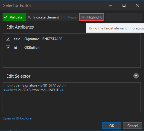

The 5 different “OK” buttons, while technically all on different pages, all have the same exact markup:
Also the SELECTOR is the same on all 5 “OK” buttons, but it also always seems to be able to find the button when i click “HIGHLIGHT”:
So i believe this has something to do with it randomly failing to find the button. Sometimes it fails on the 1st “OK” button click, but mostly its on the last, the 5th, button click:

I’d like to post an update to this. The issue still isn’t fully resolved, however more fully-qualifying the “OK” button clicks using UI Explorer seems to have reduced the failure rate from 1 out of every 2 or 3 runs to 1 out of every 6 or 8 runs. It is an improvement however i am still getting this issue.

It’s most likely a coincidence, but I’d be interested to see what the errors were in that image you showed where they were failing.
The “UiElement is no longer valid” error is a tricky one to solve, because that means the website is acting weird. If you are using Attach Browser, try using Attach Window instead. Or if the code is inside an Open Browser, then try placing it outside of it inside an Attach Window. You can also try placing the code outside of the Attach Window and use all full selectors instead of partial selectors. - I’m suspecting there could be an issue with the parent selector in the Open or Attach activity. Additionally, if you are using Chrome, maybe the website is not performing well in it and needs to use IE, or vice versa.

Here’s a list of the last 11 runs today and their errors. For testing purposes only i have it set to run every 15 minutes from 7am to 5pm M-F.
Successful

Per @dmccammond , I used the UI Explorer to more fully qualify my Selectors. It turns out this was a mistake, however, for SOME of my Selectors. It turns out one or two fields in the process actually move around a bit on the page occasionally, depending i think on the data loaded. Because of this, i was actually getting consistent failures after fully qualifying my Selectors. I found the one Selector it was always failing on, though, and instead i UN-fully-qualified this specific Selector (leaving only webctrl’s id and tag parameters). This seems to have fixed all of my issues up to this point.
