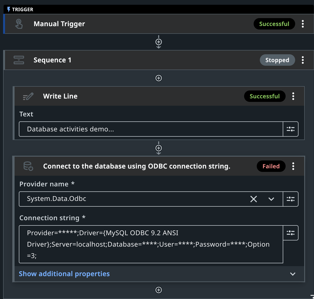

I tried creating a DSN for the local MySQL database in my local. I am getting the below issue when I use the connection string with DSN name:
Error: System.Data.Odbc.OdbcException: ERROR [01000] [unixODBC][Driver Manager]Can't open lib 'MySQL ODBC 9.2 ANSI Driver' : file not found

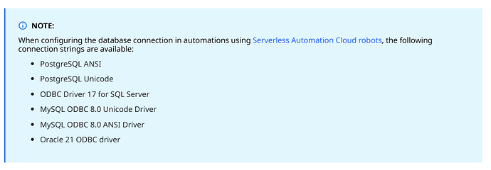

We have recently learned about the difficulties in being able to properly install the MySQL ODBC driver on the macOS system.
As a workaround, I tested and our UiPath Serverless runtime could be a valid solution. It has the following drivers installed on the default image:
  • MySQL ODBC 8.3 ANSI Driver
  • MySQL ODBC 8.3 Unicode Driver
I was able to connect to my MySQL database with the following connection string:
Driver={MySQL ODBC 8.3 Unicode Driver};database=information_schema;db=information_schema;no_schema=1;pwd={mypassword};port=9999;password={myPassword};server={myServerUrl};uid=myUsername;user=myUsername;multi_host=1
