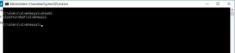

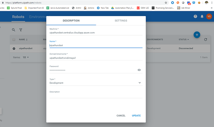

I have got a Windows VM in Azure with Robot installed. The details of Robot below.
User details of my Azure account below
Orchestrator side details below
I have done everything by the book to connect the Robot to Orchestrator as Development and facing Robot Unavailable error as shown below.
Please let me know what i’m missing. Thank you.
@vivek.rajs
the Machine name in robot tray(UIPATHUROBOT ) and orchestrator(uipathurobot.centralus.cloudapp.azure.com ) seems to be different, correct the machine name and try again.
vivek.rajs
(Vivek Raj Selvaraj)
May 22, 2019, 9:54pm
3
@Sreelatha278 Thanks for your help. It worked. I thought the DNS name should be the hostname as the host is in cloud.
Looks like the discovery of the hostname is not via the DNS but by the orchestrator configuration.
