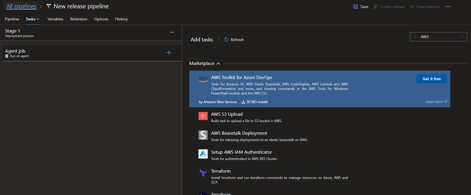

Hi @Neeraj83, @anupamck, @Alaz
It looks like UiPath has partnered with AWS yesterday (Blog post 15/12/2021) : Increase Operational Efficiency and Drive Faster Business Outcomes with UiPath Robots on AWS | AWS Partner Network (APN) Blog (amazon.com)
What this means it that one should theoretically be able to create a CI and CD pipeline within Azure Devops and deploy the process package to AWS via AWS Toolkit for Azure DevOps - Visual Studio Marketplace in Azure Devops
I have not tested it myself, but as per the AWS blog post, you almost have the same features as in Azure. Probably, even better than Azure as AWS does have a plethora of cognitive services to consume.
