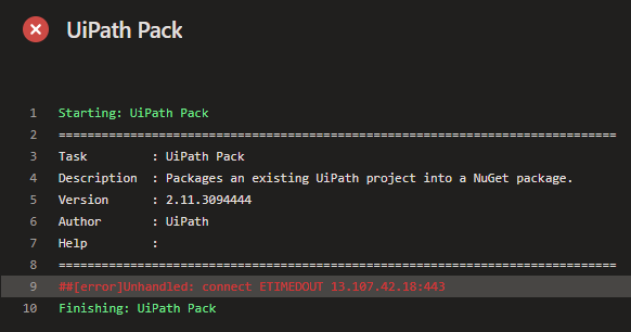

Hi Thomas, since the update yesterday we are facing an issue in our build pipeline:
We had some similar issue back in July 2020 and solved that by adding the Task “UiPath Install Platform”. We still have the task inside our pipeline.
Can you please advise how to solve the issue again? Currently blocking our deployment completly.

Hi Patrick,
with our latest release we have introduced a dependency to a new nuget feed for our CLI - this feed seems to be not accessible which is why you get this error.
short term fix:
You can step back to the previous version by explicitly specifiying the build version in all your UiPath tasks within your yaml files.
like this:
  • task: UiPathInstallPlatform@2.10.2941586
  • task: UiPathTest@2.10.2941586
mid-term fix:
pls make sure that the following URL is whitelisted in your environment:
https://uipath.pkgs.visualstudio.com/
pls let me know if this solves the issue on your side.
Hi Thomas,
did you enforced that again with your newest update from yesterday? Getting again the time out error …
Hi Patrick,
our fix for unknown reason also re-disabled caching again. We have fixed the problem and are pushing it out right now.
Apologies for the inconvenience.
BR
Thomas
thanks for the quick response. Please let me know when your update is live again. Currently still getting the same time out.
