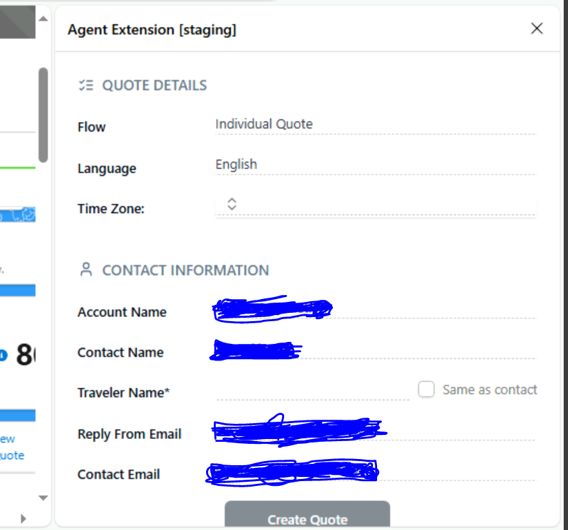

There is a client party browser extension which is downloaded in edge, need to be automated using UiPath but UiPath actually not able to detect its selectors. Tried with CV as well as tried to inject js still no luck. Please suggest what actually need to do here.

Have you tried changing the framework to uia/aa etc while trying to indicate scope/element?

With latest chrome version interqcting with extension might be an issue
But ideally CV should be supporting and try to indicate using AA mode instead of uia
Also last resort can be use hotkeys to interqct with it
Hello @sonaliaggarwal47 it worked, thanks you so much for your suggestion. Please advise about unattended bot as well. I mean would be able to run in unattended mode.
Hi @Anil_G it worked, thanks you so much for your suggestion. Please advise about unattended bot as well. I mean would it be able to run in unattended mode.
@Tanya_Verma
Glad to hear it worked.
What did you do finally that helped? changed the framework?
@Tanya_Verma
Glad it helped
And yes it does work in unattended as well
